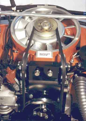

(permalink) Jensen Member
Du siger at blæseren ligger ovenpå motoren. Er det denne type (fra Riechert tuning)? Det kan godt bruges i din type1.
Yep, that is it, very very cool look ! :-)
(permalink) Farmer Member
Alright, that changes the installation procedures quite a bit, - to the positive side.
